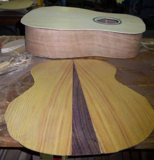

Well, I offered it up for sale or trade, and aparently nobody was interested.  So..... I decided to get a little creative, use one of the rosewood fingerboards for a filler, and a new OM has begun it's life
It is a little different looking, but I kinda like the look of the 3 piece back.

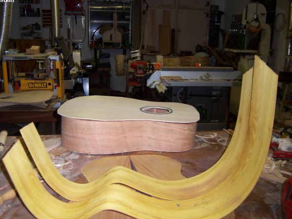

Next thing was to try bending the sides... I have never worked with Osage before, so this was a little trial and error work. This stuff is as close as I have seen to Braz as far as density and weight, so I decided I would thickness the sides to about .085 and just try to bend them without any water at all. To my surprise, it bent beautifully with no water at all. I turned the heat on the blanket full blast and waited until I could see the wood start to give a little, then cranked down on the waist and then slid the side cauls in place. I then cut the heat to meduim for 15 mins and let it cool to room temp again.
There was a little spring back, but nothing I cant take care of when it goes into the mold.
By the way, that is a curly cherry dread I'm working on behind it... been carving braces for the top all day.
